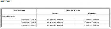

Out of curiosity, what piston clearance are you running? The pistons I bought spec. 0.0015" piston to wall, which seems really tight, but they are also designed at 16:1 compression ratio, so I guess they need to be as tight as possible.

OK. The VM Motori spec uses tolerance classes which makes it a little harder to follow unless you are using their pistons. I'm just going with what the mfr. for my new pistons recommends(0.0015") which is about in the middle of the range for the VM Motori tolerance classes (0.0009"-0.0031"). Since your machinist builds tractor pull engines, I'm sure they have a good idea of what it should be, which is why I was curious.
