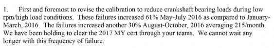

You ask I will provide I have More to add, it will take some time. FCA inner communication.
2,549
734
............................. Jan 20 2018 16 Months after production stop EPA Cease and Desist Production (Order) 6 Months later EPA filed (AECD) CAA violations. 64 Engines failing Per Month 16 after No production.

TC Diesel, thank you for the supporting details. What calibration is being discussed, ECM calibration? This is good information, and will be useful for use within an arbitration case. I'm attempting to open multiple Investigation cases against MOPAR and FCA because of this engine failing and being told that I am 100% financially responsible for paying them to fix it.

That was the OEM OP 2014-16, VM and Bosch scabbling to stop the hemorrhaging VIA OP, it failed, nothing could overcome the QC at VM cento Italy. Like I mentioned before the absolute requirement by most Powerplant makers is 1 Per 1000 for rotating mass failure rate, most hit 1 Per 3000s. Production for the Eco Ram was 2200 to 2400 Per month 2014-16.5, that Means you are 300+ Times more likely to have rotating mass failure then Most power plant ratio's in today manufacturing during 2014-18.
