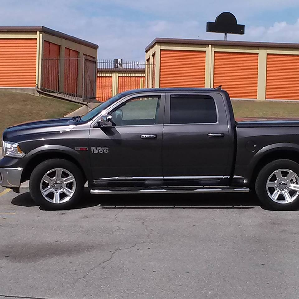

I ordered: Wheels - Fuel D561 Crush 20x9 5x139.7/5x150 +1mm. Tires - 33 X 12.5 R20 Toyo RT.
Doing the 1.5" leveling trick with the OEM air ride sensors.
Tires are only about an inch wider than stock, stock wheels are +19mm offset and Fuel wheels are +1mm offset.
Will eventually put the factory wheel/tires on the 1969 D100, with wheel adapters or drill the hubs to 5-5.5.

Did the leveling trick, but the 33", 12.5 would still rub. Went with the Toyo 275 x 60 r20 a/t tires.
I like the leveling effect it was 1 3/8" raise to the front fender.
